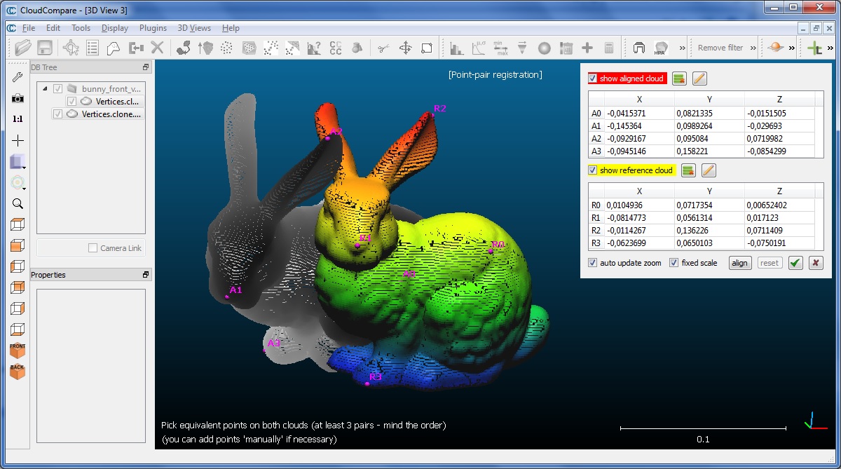

I couldn't reproduce the issue: I loaded two points clouds (with RGB colors --> this is what you are calling texture, right?) and I launched the 'Align (point pair picking)' tool (I guessed this is what you are trying to use because you can't use the ICP registration process, am I right again?). The clouds then lose their color just the time of selecting the reference and the compared one, then they get back to their original state (see image below).
If one of the 'cloud' is in fact a mesh with a real "texture" (coming from Photomod for instance), then you'll need to convert first the texture to RGB colors (Edit > Mesh > Convert texture/material to RGB).

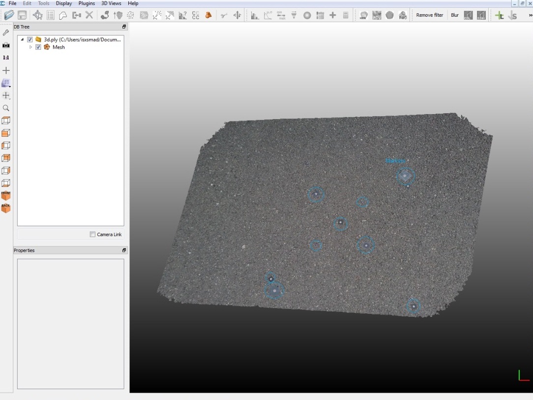

thanks for quick reply, actually, I am aware of that type of registration. In my case I have a flat surface which there are no edges or sharp features that both surfaces can share. I have attached for you a copy of the surface. So as you can see, thee are markers on the surface which I want to use them for registering the two surfaces. So when I use the align registration, these markers lose their texture temporarily. In this case it is difficult or impossible to find the markers. Is their any ways to first write down the xy and z of sharing points.
