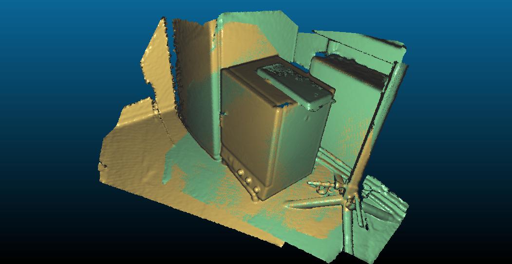

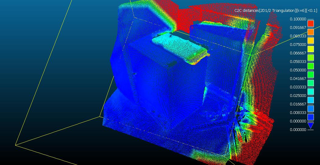

OK, now synchronize goes fine. Thanks !
I attach a snapshot of the two aligned point clouds (with a previous segmentation task).
As you can see , the blue point cloud has a more reduced box that the brown point cloud. So, it is a problem when I do the compute distances because I would like to compute only the overlapping zones.
1. Is there any way to specify a compute distances for only the overlapping zones ?. I could do it cutting manually the clouds but I would like to do in the batch process. I also think to make a common box size for both clouds but I could lost some overlapping points.
2. I can use max. distance to limit the distance calculation only to the nearly overlapping points but if I do it, histogram will take into account only these points or also the full point distances ? . My batch process should obtain only true distances and make decisions based on percentages calculated in the histogram (only for the overlapping/nearly zones).

- max distance to 10 cm

Re: Batch synchronize process
Differences in entities extent is indeed a (very) difficult issue.
Theoretically speaking, the only good way to handle it automatically is to know the 'reference' sensor point of view (and maximum range, etc.) and check that the 'compared' points do fall inside this point of view (i.e. that the compared points "could have been seen" by the sensor which has generated the reference data set).
In practical it's generally impossible, and you must use very rough heuristics such as the 'reference' bounding box as you suggested (maybe the convex hull could be better, but it's not even worse the cost). You'll always have points falling outside the bounding box that you would have 'wanted' compared, and points falling inside that you wouldn't want ;)
The 'max distance' parameter is just a slightly better heuristic (but you will still get some points of the compared cloud lying near the compared mesh borders with virtually high distances). And as you guessed all the points lying farther will have the same distance value (this 'max distance'). If you don't want to see them appear in the histogram, you should set them to 'NAN_VALUE' after the distance computation is done:
Note: graphically those points will appear in gray by default, and you can hide them with 'ccScalarField::showNaNValuesInGrey(false)'
