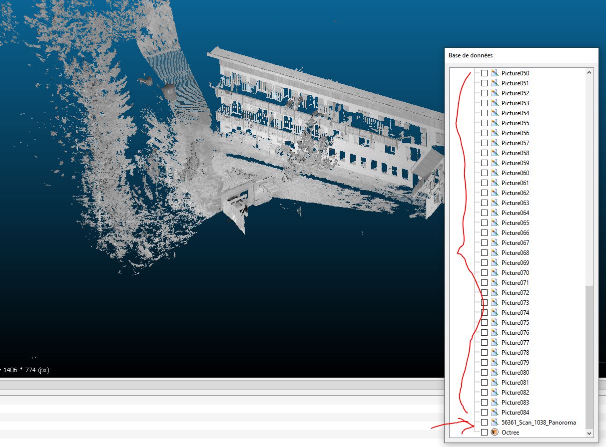

We have exported a raw FARO laser scanner station from FARO Scene in E57, with the pano image embeeded into the E57 file.
that file is 508Mo
that file is being imported into CC , the point cloud is present as well as pano image (broken down into native picture shots + pano image)
then I export again that file again in E57
now that file is 625Mo
Strange isn't it ?
I have imported again that new E57 to see if there was any changed in the file structure from DB view...

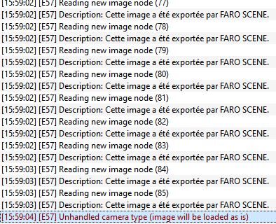

Just to let you know that the native E57 file that comes from FARO SCENE returns a warning in CC console
any idea why ?

So CC doesn't handle all sensor and camera types (so at least the warning is not unexpected).
