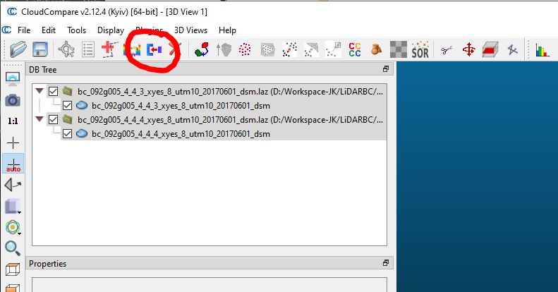

I think the EXPORT option works on only one cloud at a time (as I do not think there is a provision in the exporter to do multiple export instances). This had me stymied for a while as well.
The way I solved it is that I made copies of the clouds, and then joined all the copies into one overall cloud. I then exported that.
Use the "Edit"=>"Merge" commands to merge the clouds together.
