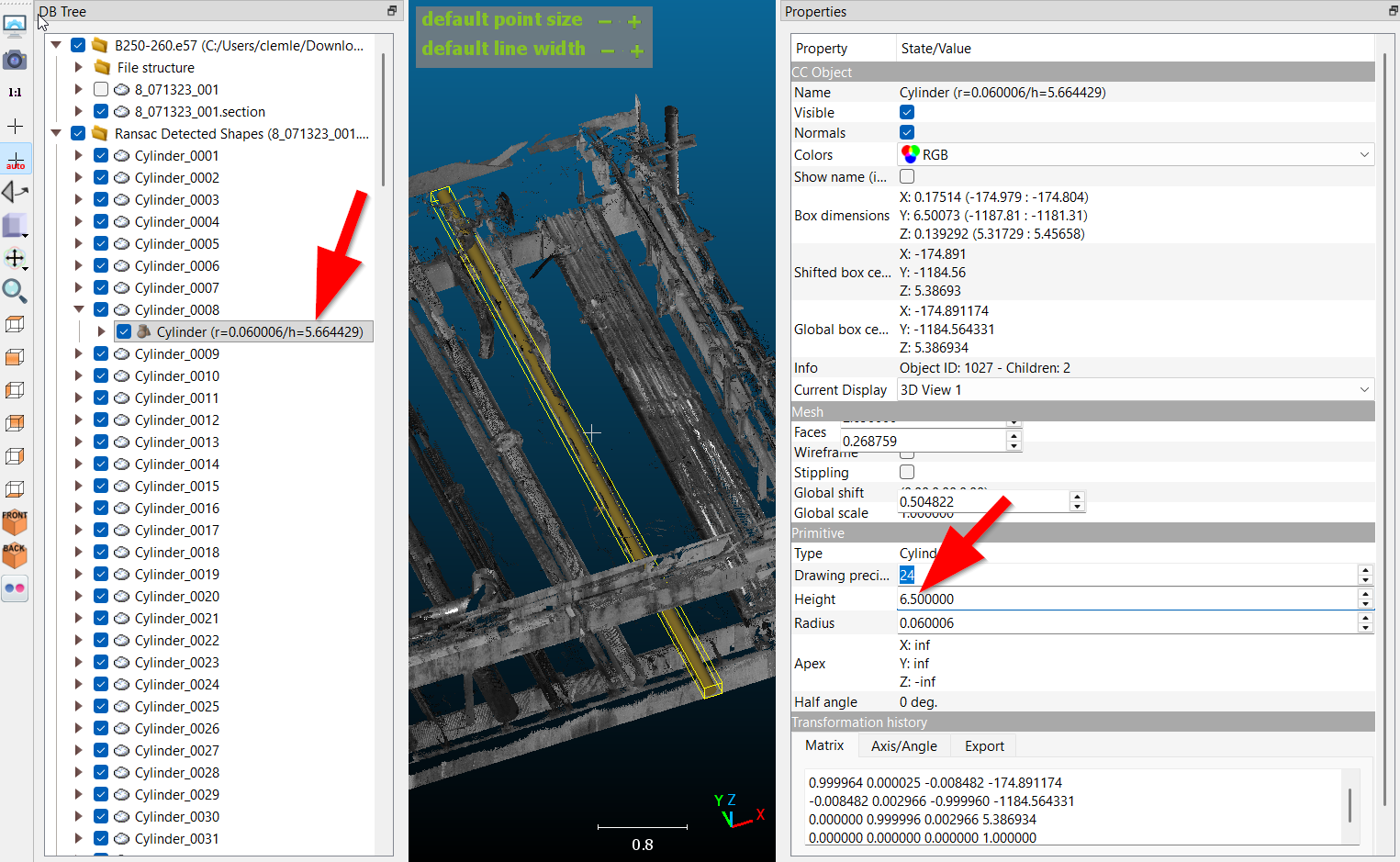

That is helpful and worked to get the original radius and height of each cylinder. An improvment would be to get the current radius and height directly from the primative attributes. For some shapes, I need to adjust the height after RANSAC fitting so the actual height no longer matches the name (see attached screen shot).
Is there a way to access/export the primative attribute table?
RANSAC export changing attribute issue.png (414.36 KiB) Viewed 51641 times
Re: Ransac - export just meshes
You mean programmatically?
