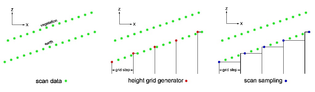

I was thinking of a simplified method of bare earth extraction that uses the octree structure:
1) define a level of octree subdivision
2) divide the point cloud into columns of octree cells and choose the lowest point of the lowest octree cell of each column
3) create a new point cloud with points selected in step 2
it should be a quick and easy way to remove sparse vegetation, people, cars and vertical or overhanging objects from scans
Alberto

the heigh grid generator forces the creation of a regular grid, can you only sample the existing points?
Re: bare earth extraction - simplified method
Good idea. We should add an option to do this with the Height Grid Generation tool. I'll add this to the TODO list.
