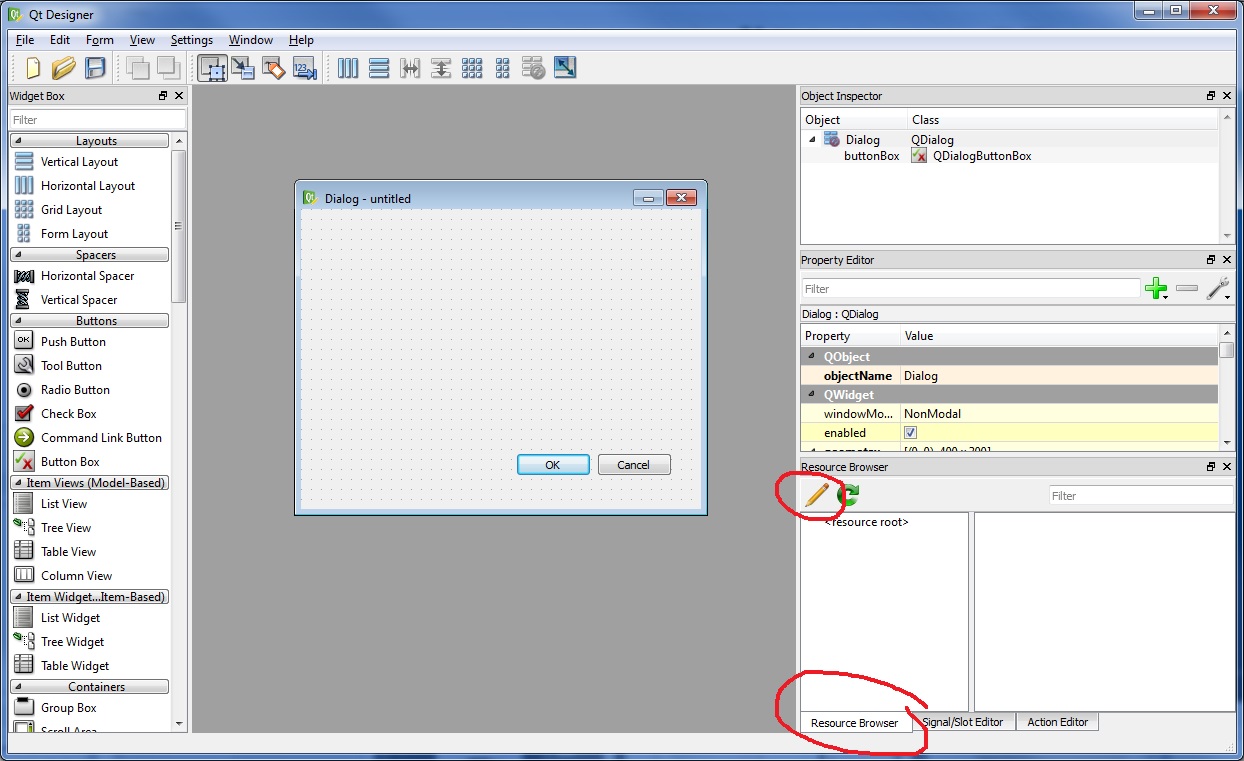

What version of qt designer are you using?!
Here is where is mine ;)
Qt designer RC browser
Re: Using qrc file in ui file
Posted: Fri Nov 15, 2013 3:53 pm
by jsm
I have not this "Ressource browser".
Ok. I think I know. I am working with Qt Creator, in the designer tab. I thought it was the same. My interface is quite similar to yours, except I have some other buttons onto the left... I will try with the real Qt Designer.
Thanks.
