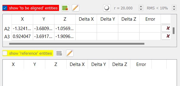

Hello, something similar is happening to me. I’m trying to align two clouds with that tool, but I can only pick points on one cloud. I can’t do it on the other one, and I don’t get the option to show that cloud either. I can only add R points with the pencil, but that’s not helpful. I’ll attach a picture.

Have you selected maybe both clouds as 'to be aligned' when starting the tool? Only the one that should move should be selected in the small dialog that appears first (with the list of all the clouds you've highlighted before starting the tool).
