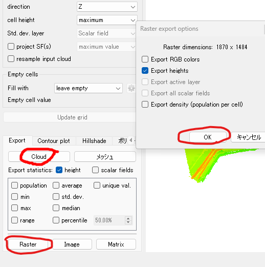

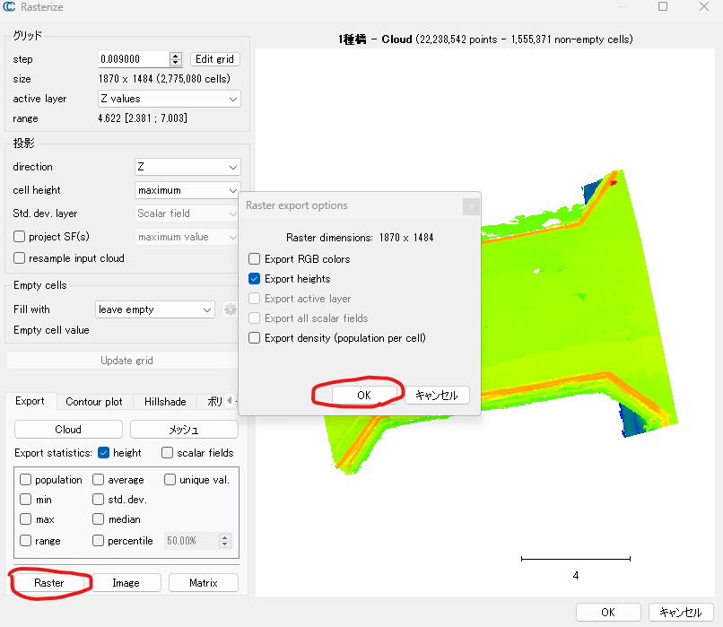

I want to export to Geotiff using Rasterize.
I did it as shown in the image.
I imported it into QGIS.
However, there was no height information.
How can I make it taller?
スクリーンショット 2024-07-16 115054.png (61 KiB) Viewed 7725 times

Are you able to get Z value in CC by exporting raster cloud?
Use Cloud button

I had height as data in QGIS.
The following steps were required to display the height
Thank you for letting me know that raster data can be output as a new cloud.
Exporting this allowed me to use only the data I needed in CAD.
