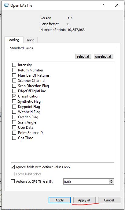

Having an issue with the Apply All button in the "Open LAS Dailogue Box" in v2.13.1 and v2.13.2
Behaving as if it is Apply button and only working on first selected file and not multiple files
Can anyone confirm? Thanks.

Do you mean it only works on the first file of your selection? Or on the first file you load and not on the next ones? (because I believe this button is only if you have selected multiple files at once).

Correct, first file of a selection of two or more files at once. Only one file of the group will have the Standard fields applied.

This should now (partly) be fixed in the latest 2.14.alpha version. CC should now be smarter and really remember the 'configuration' of the scalar fields to load or to ignore (whether using 'Apply' or 'Apply all' actually).
However, regarding the fact that the dialog reappears when 'Apply all' is selected, this seems to be related to the fact that the file is not exactly the same. The criteria to consider that 2 files are equivalent are:
- the version must be the same (X.Y - both X and Y)
- the number of extra scalar fields must be the same, and the extra scalar fields must also be identical
