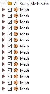

I have a folder with multiple meshes (.ply files) and use a command line script to regroup them into one single .bin file. The .ply files have all different names, but once regrouped into a single .bin file, all meshes are simply called "Mesh" with no other way to distinguish them in the DB Tree.
Is it possible to import the meshes while keeping the filenames referenced?

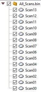

I use the command line to open a .bin file with multiple clouds and export them one by one as .asc files.
The original .bin file has following DB Tree structure
To export the files, I provide filenames, creating a list of names.

I have only now had time to look at it again, and found a way to rename the meshes which works for me.
Since it will use the "type" as base name once opened, it's possible to, immediately after opening the file, select the opened file with a regex pattern (the base name) and then renaming it with the -RENAME_ENTITIES command and the Filename.
As an example I used this code :
