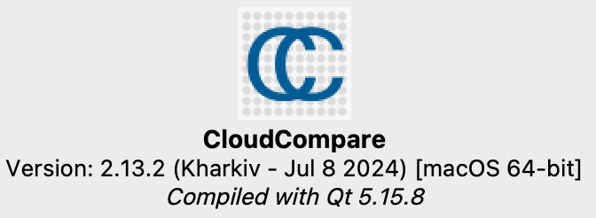

Hello CCers:
I'm running CC on a Mac with M1 silicon.
Attachment 0.jpg (31.51 KiB) Viewed 44086 times
A function related to specifying the center of rotation appears to not be working.
Double clicking does not cause the COR to change.
Any advice on why or how to fix this?
Sincerely,
Ken

Sadly many things are different on macOS... hard to tell. Also, make sure there are some points below your mouse cursors (but I guess it's the case).
