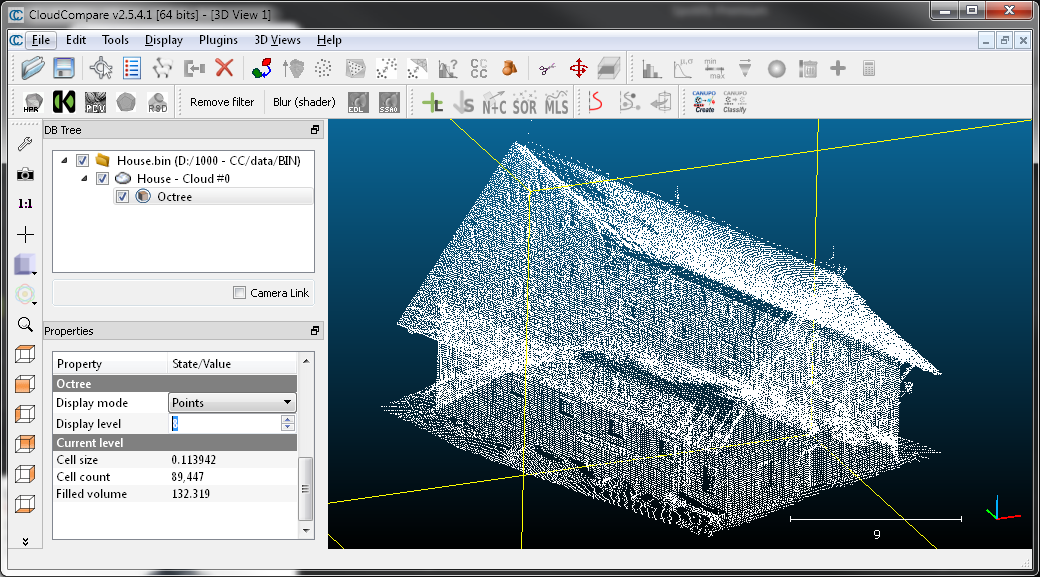

You can partly achieve the same result by using the 'octree' displaying properties.
First you'll have to compute the octree on your point cloud (Edit > Octree > Compute). Then hide the cloud (with the 'visible' checkbox in the cloud properties). Eventually select the octree entity in the DB tree and change its Display mode' to 'Points' 'and its 'Display level' to a relatively high value:
