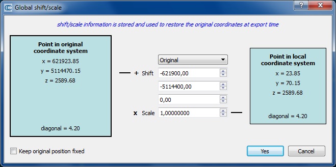

Okay I've worked on this subject (too much) and here is the outcome:
  • sadly all the solutions based on a "per branch" global shift setting are very interesting but can't be used in CC (this is a more global limitation: all the "scene graph" and equivalent hierarchical 3D positioning schemes are not compatible with fast comparison/processing of points - or it would cost too much memory to temporarily transform the clouds before processing them).
  • what is closest to a "project" in CC is a BIN file (as you can store about anything inside - even labels and viewports - so you can basically save all your entities in a single file and reopen them later). As global shift & scale information are also saved in BIN files, we can say that we have almost a "per-project" setting (hum hum).
  • the "global" once-and-for-all option is of course very tempting... but I'm still not sure I want to chop down the tree yet. So I've tried a (last?) attempt to improve the actual system. If it doesn't work better I'll draw the axe out...
The improvements consist mainly in two things:
  • I've implemented the "bookmark" mechanism suggested by DImitri a while ago (a global_shift_list.txt file next to CC's executable with pre-defined and named shift/scale sets - a template file will be shipped with the next releases)
  • a new dialog, hopefully clearer and that can works in both ways (i.e. either when loading a file or when editing the global shift/scale information). It can be used on one or several clouds at a time. And I even implemented the option to keep the "true cartographic coordinates" constant.

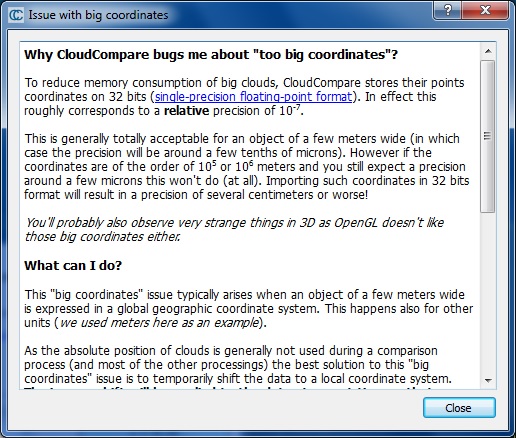

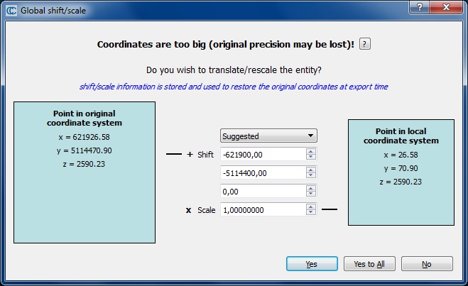

Here is the what the dialog looks like when loading a file (the combo-box let the user choose between the current suggested values, the previous one - if any - and the ones found in the 'global_shift_list.txt' file). When the user edit the shift/scale information, the 'original' and 'local' point coordinates are automatically updated so as to get an idea of the result:
You can get more information by clicking on the "?" icon by the way :
Here is what it looks like when editing the global/shift scale information afterwards (you'll notice the "keep original position fixed" checkbox). This dialog will also appear (with small differences) if the user applies a transformation that makes the cloud go out of bounds:
