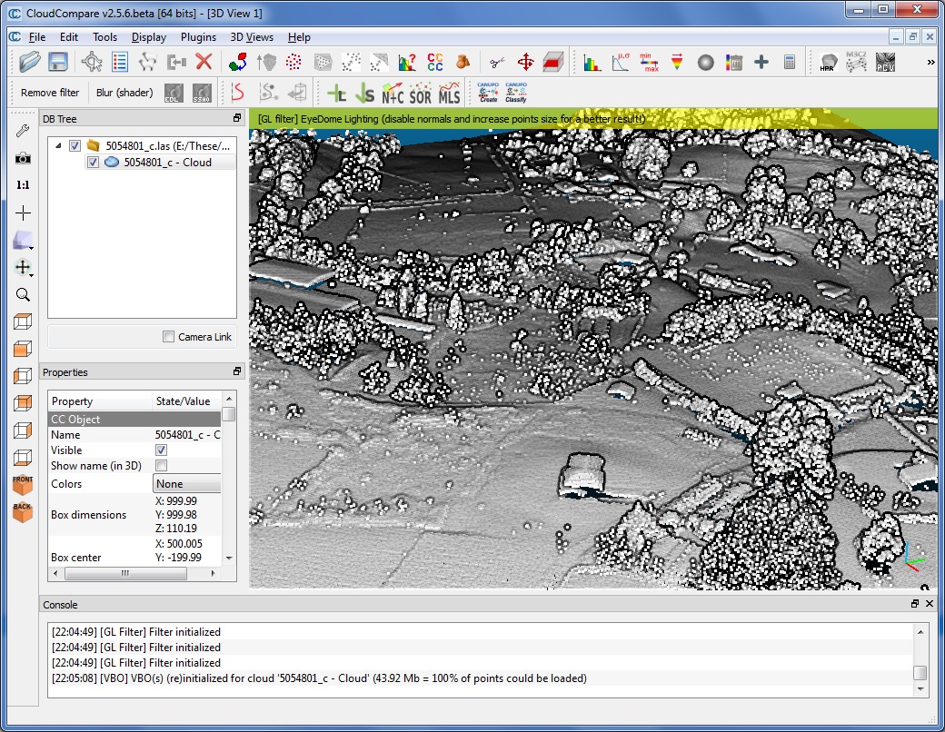

Hi there,
I like EDL so much that... its little issues mess me up! :)
In centered perspective, when you are close to the object (in the bouding box ??), EDL doesn't work:
But if you only click on the scissor (segmentation), without moving the camera, it works, since you don't move the camera!!!
Any idea to fix that issue ??

Ok, I finally understood what happens: when you select the scissors tool, CC adds a (2D) polyline to the window. This mistakenly changes the bounding-box of the displayed entities (that's a double mistake because: first the polyline is not visible when the tool starts and second it's a 2D element, not a 3D one! - I fixed this). Anyway the bounding-box is changed, and potentially greatly because the empty polyline line in its initial state is like a point placed in (0,0,0). This totally changes the depth-buffer normalization of the graphic card, which directly impacts the EDL render.
In your case, this glitch gave a better result. But that's pure chance, because in most case it worsens it... This issue shows once again that this depth-buffer normalization done on the GPU side is really the big problem of EDL. I've just found an interesting article on this problem here (I'll look at it more in depth in case it gives us a practicable solution):

Yes! It was a good source indeed. Now EDL works in perspective mode!
You'll find the corresponding beta version here:

Daniel, thanks for this first Fix.
I encoutered a systematic crash... I'll wait for the next fix!

Hey Daniel,
it was buggy with a Iris Pro 5200.
When I use it on a real Graphic Card, it's OK. Just have few artefacts, kind of "waves" or "tiles" on planar surfaces at medium distance, but anyway: THANKS for this new version of EDL !!
