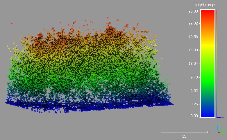

Here's what I get:

Posted: Mon Nov 20, 2017 12:24 pm
by Sile
Daniel,
That worked perfectly. The problem I believe I was having was not having the correct Active field selected. Thank you so much for working with me on this problem and I hope others find it useful as well. Cheers!
