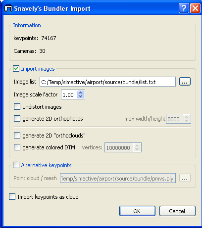

I am trying to import a bundle.out file into CloudCompare V2 04/25/2012 on Windows but am encountering an error saying
"BundleFilter:loadFile] Failed to load image xxxx.jpg'! (check your list file and be sure to put images alongside)
The files are actually there but the import isn't going through.
Does anybody know what is going on and how can I fix it?
thanks

I read through some of the source code and from what I understand, the function in question is loading all the images into memory, until all the Ram is used up. At which point, the import will fail.
That seems to be the problem. So the immediate solution to my problem seems to be to increase the amount of ram available.
So I tried on a Win7 64 bit with 8gb ram but it still couldn't go through.

I ran the recompiled code.
Fyi it works but after a random number of images, there will be this error message (see screenshot). At which point, the process will seem to be looping forever and nothing else will work.
thanks
